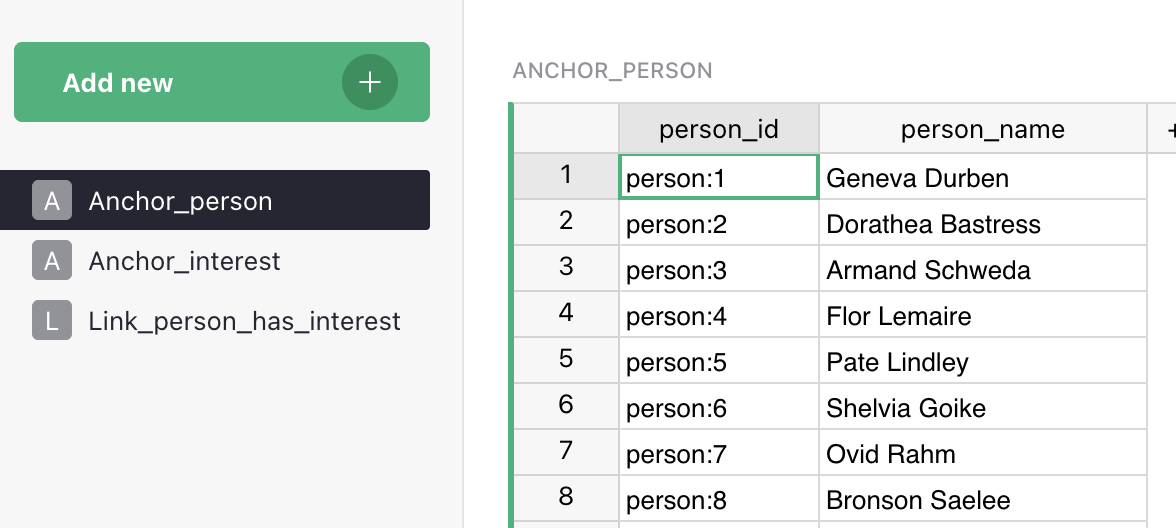

Table "Anchor_person" showing person_id and person_name.

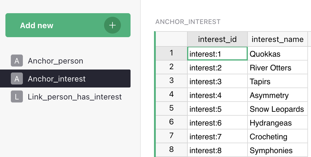

Table "Anchor_interest" showing interest_id and interest_name.

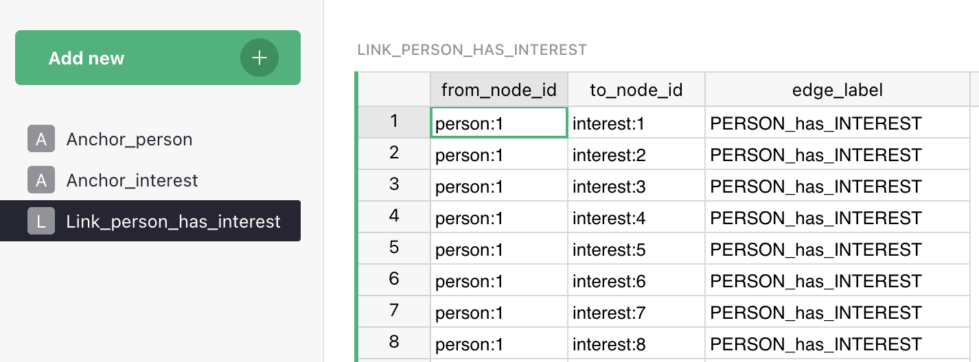

Table "Link_person_has_interest" showing from_node_id, to_node_id  and edge_label.
Structured data managed in Grist: two tables and a reference column that links them. Grist keeps the relationships between tables, not just flat rows.

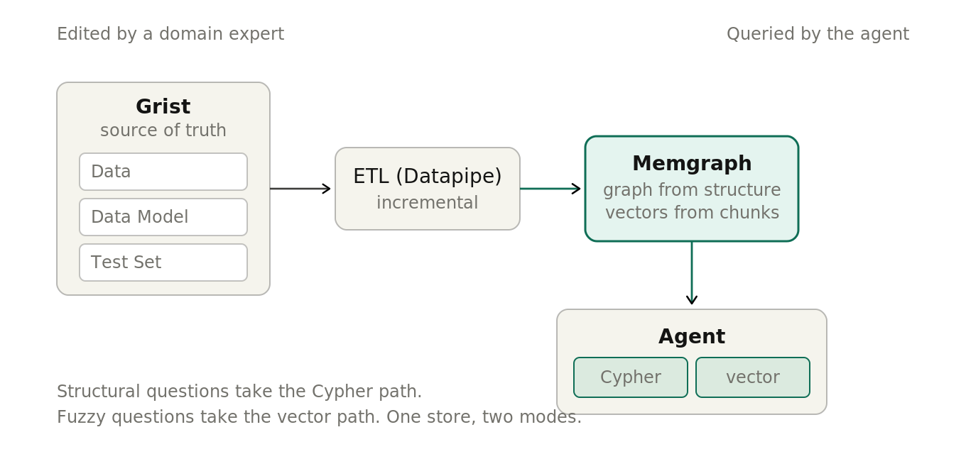

Under Grist we run a graph database called Memgraph. Everything from Grist flows into it: the tables become a graph the assistant can walk, and the text chunks become searchable by meaning. The assistant then answers two ways from one place, a precise query over the graph when the question is structural, and a meaning-based search over the text when it is open-ended.
Flowchart showing the flow from Grist (source of truth) to the agent via Memgraph.
From Grist into Memgraph: tables become a graph the assistant can walk, and text chunks become searchable by meaning.

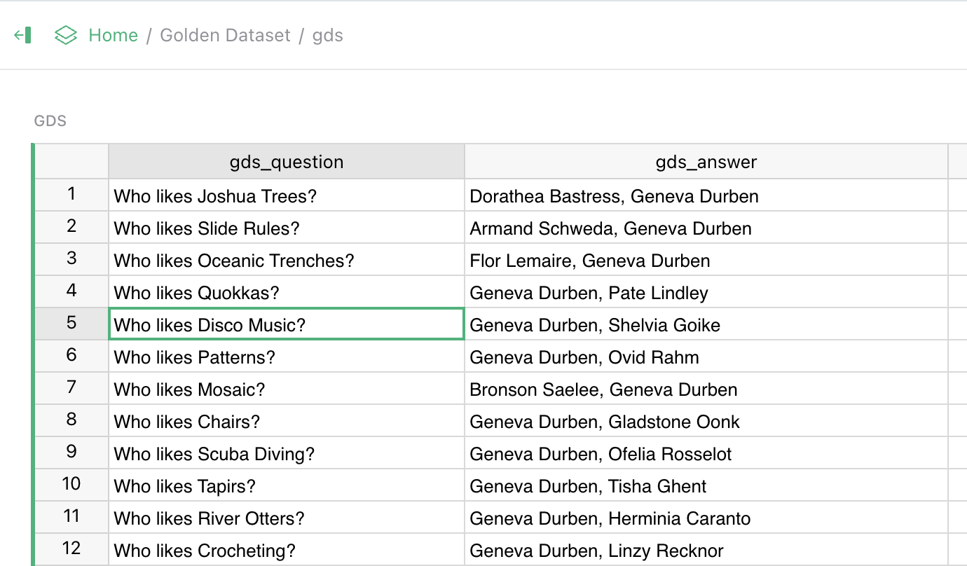

You also need to know whether the assistant is right. Another Grist document holds a “golden set”: questions paired with the answers you expect.
The golden set table, showing questions and expected answers.
The golden set in Grist: test questions paired with the answers we expect.
The default golden set is LIMIT, the benchmark from the opening, so the screenshots in this post come from it. The headline number is hit rate, the share of test questions answered correctly. On our version it is around 40-60% for plain text search, and 90% or more for Vedana answering over the graph.
Every change runs against this set. The failures are the useful part. Wrong values point at the data model, a whole topic failing points at the Playbook, and shaky answers to similar questions point at a search setting. Quality becomes a loop: change one thing in Grist, reload, measure again.
